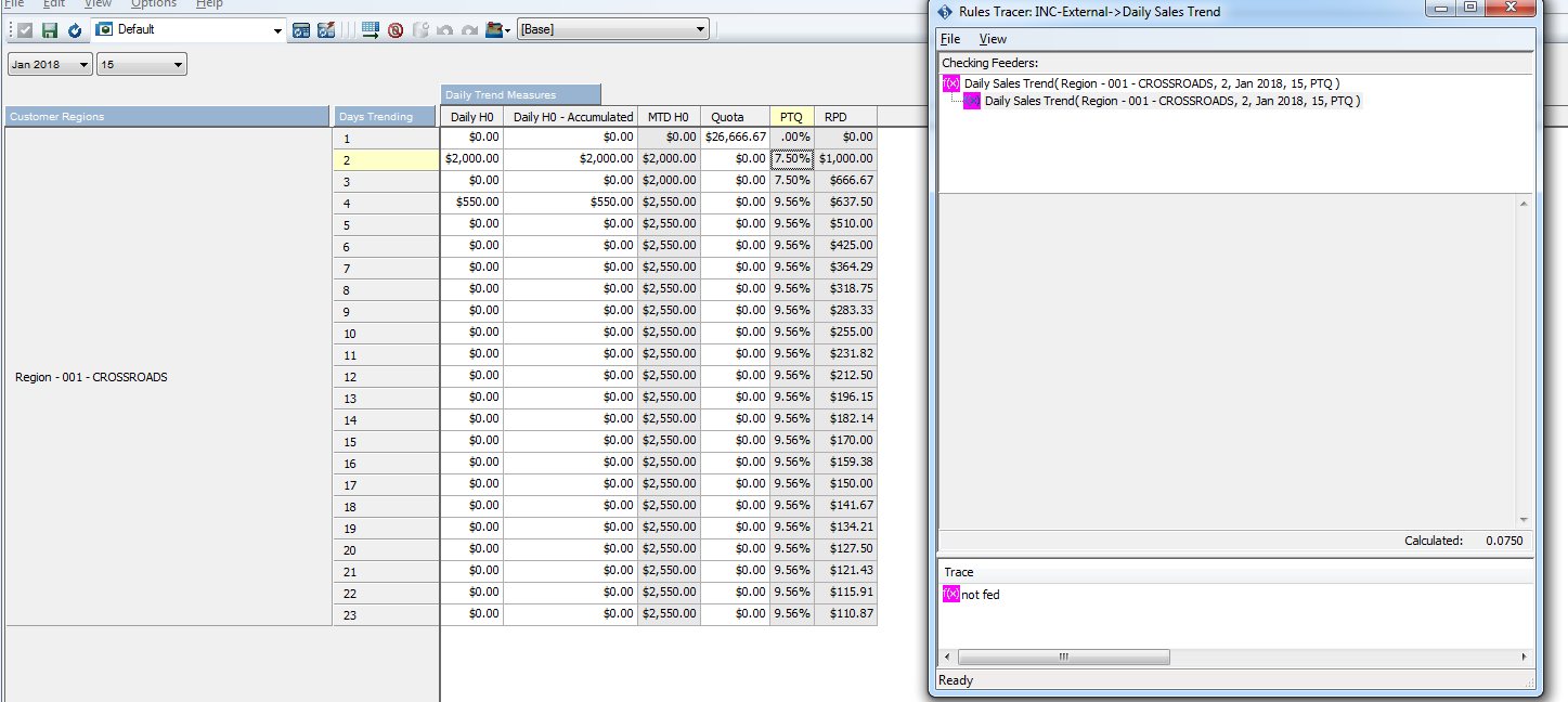

Hi To calculate MTDH0 which is a cumulated value I use the below rule and it works fine .
Then I calulate RevenuePerDay and Percentage to Quota as a rule .
But while doing zero supression both columns pTQ and RPD disappears.
I have attached the image of my view with lowest level data and check feeders calculation .
I dont see any issue with my feeder but not sure if the feeder is fired .
Revenue per day = Mtd Revenue /Day No
PTQ = MTD / Quota
MTD H0 is calculated if there is a value for Daily H0 - Accumulated Column and that works perfectly when zero suppressed , the issue is only with RPD and PTQ which depends on the rule calulcated cell MTD H0
Any help is appreciated .

- Steve Rowe
- Posts: 2456
Re: Feeders Not Fed
I know what the answer so I'm going to give you some clues.
If you think about this in a logical manner it should be straight forward to understand.
Work backwards through your feeder logic for Day 7.
RPD is not fed, my feeder says it is fed by MTD H0 or Daily HO.
Therefore both MTD HO or Daily HO must either be zero or not fed.
I can see that Daily HO is zero and so won't trigger the feeder this is expected.
MTD HO is ruled and non-zero and so should be triggering the feeder.
I know it is not triggering the feeder, therefore this value can not be itself fed.
So my feeder for MTD HO is wrong.
My rule for MTD HO is
['MTD H0' ] =DB('Daily Sales Trend', !Customer Regions, !Days Trending|'MTD', !Months, !Product Lines, 'Daily H0 - Accumulated');
and my feeder is
['Daily H0 - Accumulated' ] =>['MTD H0' ];
I can see that I have correctly dealt with the switch in measure from MTD HO to Daily HO but I have taken no action in my feeder statement around the transformation of the !Days Trending reference.
The ruled value is dependant on days 1 to 7, however I am only feeding from day 7, since Day 7 is zero, MTD HO is not fed.
=> I need to change my feeder so it correctly reflects the dependencies that exist in my rule statement.
Feeders are not that hard but you did need to take some time out to think about the logic of what you are trying to do and think through why they may not be working. It is as simple as a=B and B=>a but you need to make sure you understand what a and B are and the shapes they occupy in the cube.
HTH!

- Steve Rowe
- Posts: 2456
Re: Feeders Not Fed
Your rule is dependant on the prior days in the period and you have built a consolidation for this and put it in your rule.
Given that feeders and rules are opposites.
Your feeder should trigger the future days, therefore you need to build a consolidation for this and put it in your feeder.
In general, whatever objects and structures you build for your rule you need to build the opposite of them for your feeders.

- Posts: 128
- Joined: Tue May 23, 2017 12:45 pm
- OLAP Product: Tm1
- Version: 9.5
Re: Feeders Not Fed
Okay its working now . Thanks for your help on this and putting so much time to explain .
I am still confused with logic and will take simple example .
Only tow days of sale
Sale CumSale
1 100 100
2 50 50
1 MTD - 1 and 2 MTD - 2 ,1
So rule
[CumSale]= DB ('Trend',!Day|'MTD', 'Sale');
so for feeder here
take an example of day 2 only .
to feed day 2 for CumSale , I need to check if Day 1 Sale and Day2 sale are not zero , why do I have to check future days .
I have to check only the past and current day right ?
Sale CumSale
1 100 100
2 50 50
So rule
so for feeder here
- Steve Rowe
- Posts: 2456
Re: Feeders Not Fed
I'm not convinced you have the basic concept of feeders correct.
A rule points at a source. A feeder points at the ruled area.
Your rule for Day 2 is dependant on the input values for Day 1 and 2.
Your feeder for Day 2 has to flag the day 2 cumulative value from the dependant values, but you can not write it in this manner it has to start from the input value.
So the input value for day 1 could trigger the cum value for Day 1, Day 2 all the way up to Day 31, which is written
[Day 1, Input]=> [ Day 1 RoM, Cum]; where Day 1 RoM is a consolidation of Days 1 to 31, which then generalises to
[Input= => DB ( .........!Day | 'RoM', 'Cum'....);
