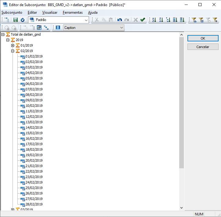

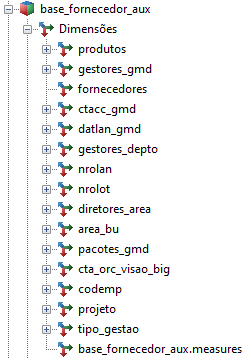

This is the first cube with the complete period:
This is the dimension with the complete period:
complete period.png (57.89 KiB) Viewed 9784 times

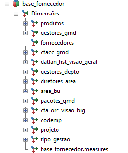

Now the cube with another dimension of period:
Please repair that this cube does not have nrolan and nrolot dimension. In this case I get the total of dimension.
I will put the screenshot of the dimension of period of this cube on another post.

Re: Rule Question
Posted: Mon Nov 25, 2019 2:33 pm
by Jorge Rachid

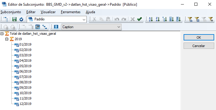

The period dimension of the cube that I want to do the rule:
short period.png (33.99 KiB) Viewed 9783 times
I want to match this period here with the same period of the first cube via rule. How could SUBST help in this case?
Thanks a lot.
JR.
