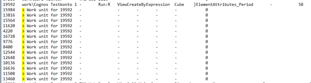

I have a question regarding MTQ, where it seems that MTQ is in effect, but CPU usage isn't increasing compared to MTQ=1. Running a TI process uses by definition 1 thread corresponding to 1/16=~6% CPU use:
When querying a cube using MTQ=-1 I would expect the query to use (16-1)/16 = ~94 % of the CPU, but it never exceeds the 6% above. In TM1Top we can see that MTQ is running on 15 threads however:
Please advice why the MTQ setting doesn't utilize the full CPU capacity?

I think I may have stated my question a bit wrong. I'm asking the more general question "why doesn't MTQ use the full capacity of the processor?" (regardless of TI processing). I.e. when opening a cube view or a Websheet we see that it's splitting the query on 15 threads but it's still only using 6% of the CPU when i would expect it to use (16-1)/16 = ~94% with MTQ set to -1.

A complete guess from your screen shot..
The view and cube you are working with is rule based and the rule dependency with the attribute cube was not built at the time the view was requested. This forces the system single threaded when the dependency is added.
Does anything show in the logs? You can probably turn the logging up as well to see what's going on under the hood. (https://www.ibm.com/support/knowledgece ... 60693.html)
I'm not aware of anything on the hardware / cfg side required to activate MTQ.
My belief (its a long time since I tested) is that heavy rule based views are less able to benefit from MTQ than pure numbers.

Ok, I see your point that TM1 shouldn't need to use the full capacity of the MTQ setting for all querys, but in this case the query had been running for up toward a minute and still it's only using the equivalent of one thread of the CPU. I'm trying to figure out if I can make it more efficient.
You are completely right! I've tried enabling more detailed logging and will continue down this path to see if I can find anything of use. I will also attempt to pre-establish cube dependencies to see if this will improve performance.
The reason I asked my original question is that we're experiencing a situation where the response times in our web sheets used in TM1Web is lightning fast (<1s), until suddenly a query can start running for >60s without warning and I always see the MTQ working but CPU use not increasing and thought this might a possible area of improvement. I'd really appreciate any other ideas on what could be done to resolve this.
