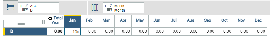

Question #15:
What will happen after you type "10>" in a cell?
Image 51.png (12.72 KiB) Viewed 38653 times
Re: Ultimate Long TM1 quiz
Posted: Sun Apr 14, 2024 12:45 pm
by Adam
Nothing. You have to hit enter first. :-)
After you hit enter, 10 will replace each of the cells in that cell and to the right. In this case Total Year will now equals 120.

Correct answer:
This will put "10" to current cell and all leaf cells to the right.
Winner of this week is Adam! (and nice catch with Enter)

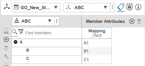

Where are element attributes stored?

by ascheevel
Dimension attributes or element attributes? Attributes for elements of the primary hierarchy of a dimension are stored in a separate, two-dimension cube with name like "}ElementAttributes_<DimensionName>". The two dimensions are the dimension itself and a measures dim called "}ElementAttributes_<DimensionName>". Attributes for consolidated elements of alternate hierarchies are presumably also stored in a similar cubestore, but that's not viewable as a control object in PAW/Pafe or Architect. Dimension level attributes are stored in a cube called "}DimensionAttributes".

Correct answer: In "}ElementAttributes_<DimensionName>" cube (Yes, I've meant element's attributes, thanks)
Winner of this week is ascheevel and he takes the lead!
