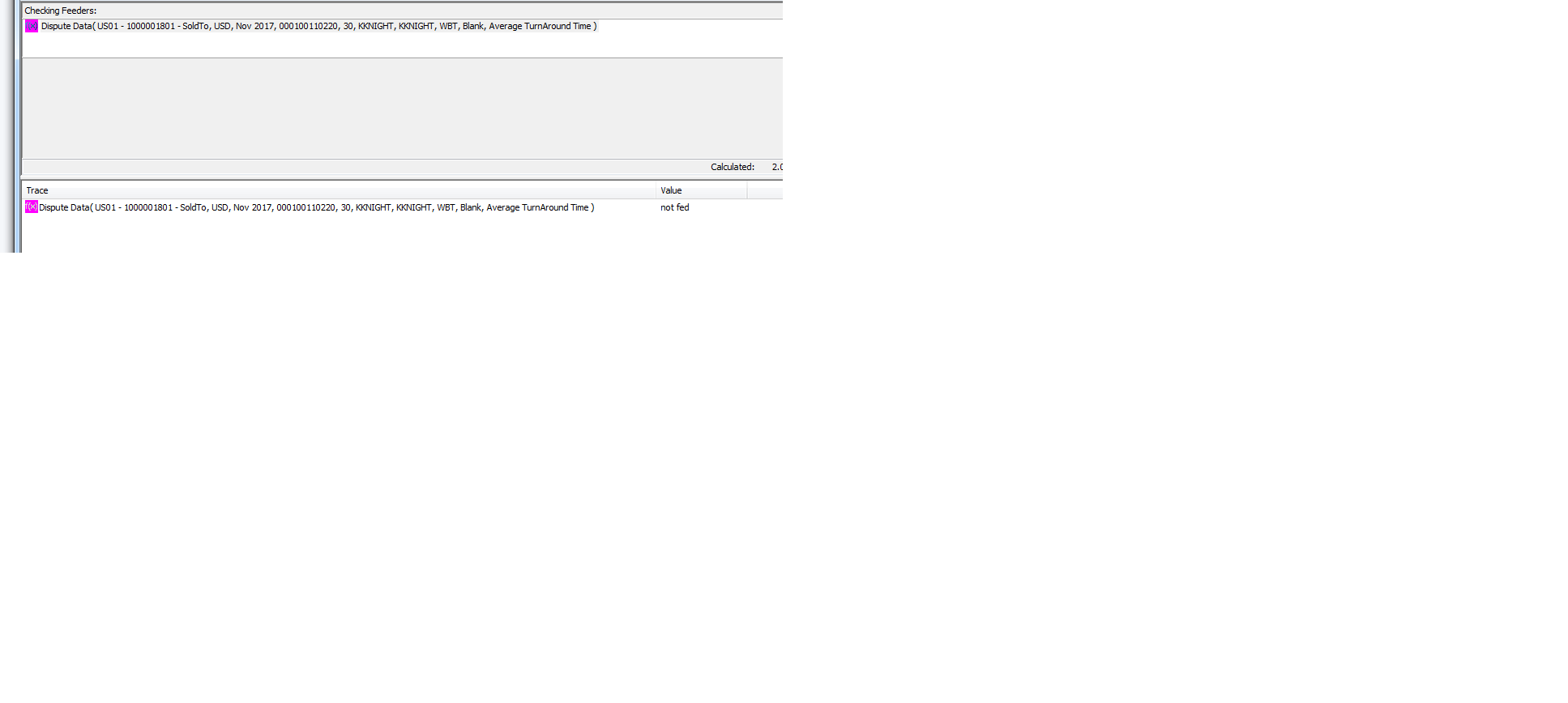

Hi I am still getting the AverageTurnaround time removed on zero suppression .
Skipcheck;
['Cases with TurnAround' ] =N: IF( ['TurnAround Time' ] > 0,1,0);
['Average TurnAround Time' ] = C: DB('Dispute Data', !Customers SoldTo Only, !Currencies, !Months, !Dispute Case ID, !Dispute Case Status, !Dispute Person Responsible, !Dispute Processor, !Dispute Reason, !Dispute Root Cause Code, 'TurnAround Time') \ DB('Dispute Data', !Customers SoldTo Only, !Currencies, !Months, !Dispute Case ID, !Dispute Case Status, !Dispute Person Responsible, !Dispute Processor, !Dispute Reason, !Dispute Root Cause Code, 'Cases with TurnAround');
Feeders;
['TurnAround Time' ] => ['Cases with TurnAround' ];
['Average TurnAround Time' ] =>DB('Dispute Data', 'All Regions', 'All Currencies', !Months, 'All Cases', 'All Status', !Dispute Person Responsible,'All Processors' , 'All Reason', 'All Root Cause Code', 'TurnAround Time') ;
I assume my feeders are the issue here , but i am telling feed my Average turn around time if there is a value for turnaround time .
Any one who can help on this is appreciated .

Analytics123
- Posts: 128
- Joined: Tue May 23, 2017 12:45 pm
- OLAP Product: Tm1
- Version: 9.5
Re: Count in rules
Any help is appreciated .
the above feeder is still gone while zero supression.
- gtonkin
- Posts: 1274
- Location: JHB, South Africa
Re: Count in rules
You may have confused yourself here. If you are deriving Average Turnaround time based on Cases with Turnaround Time, this (Cases with Turnaround Time) needs to be on the left I.e. feed from the dependent variable into the one being calculated.
HTH
HTH

Analytics123
- Posts: 128
- OLAP Product: Tm1
- Version: 9.5
Re: Count in rules
Okay this is what I got and I want some advise on how this works .
Working Rule and Feeders :
Skipcheck;
['Average TurnAround Time' ] = DB('Dispute Data', !Customers SoldTo Only, !Currencies, !Months, !Dispute Case ID, !Dispute Case Status, !Dispute Person Responsible, !Dispute Processor, !Dispute Reason, !Dispute Root Cause Code, 'TurnAround Time') \ DB('Di
Feeders;
['TurnAround Time']=>['Cases with TurnAround'];
['Average TurnAround Time']=> DB('Dispute Data', !Customers SoldTo Only, !Currencies, !Months, !Dispute Case ID, !Dispute Case Status, !Dispute Person Responsible, !Dispute Processor, !Dispute Reason, !Dispute Root Cause Code, 'TurnAround Time');
The above case works and zero suppression also works properly on Average TurnAround time column . But here I have not mentioned the rule to calculate to C level only , IF I say that then my Average Turn Aroundtime has an zero supression issue .
Not Working Rule and Feeders :
Skipcheck;
['Average TurnAround Time' ] =C:DB('Dispute Data', !Customers SoldTo Only, !Currencies, !Months, !Dispute Case ID, !Dispute Case Status, !Dispute Person Responsible, !Dispute Processor, !Dispute Reason, !Dispute Root Cause Code, 'TurnAround Time') \ DB('Di
Feeders;
Please advise

- gtonkin
- Posts: 1274
Re: Count in rules
Your second feeder is wrong - Turnaround time is the dependent variable i.e. without this, Average Turnaround Time cannot be calculated.Analytics123 wrote: ↑Mon Dec 18, 2017 2:56 pm ...
Skipcheck;
Feeders;
Your feeder is saying feed (the answer of Turnaround Time) from Average Turnaround Time - As Edward pointed out too, you "generally" need to start your feeder as the rule being switched around - what you have on the left being derived goes to the right as that is where you need the feeder.

TThanks for taking time to give the sample code .
But Can you tell me whats wrong in my other post . I had done it after reading about feeders tutorial and would like to know why feeding is not happened . I have posted the rule tracer and check feeders screen as well . .
Instead of doing case count via rules, I used TI to load count value.
so now turnaround time and cases with turn around comes from ti , All i need is just division of this .
SkipCheck;
And I have a feeder :
['TurnAround Time'] =>['Average TurnAround Time' ] ;
Is any thing wrong here , it says not fed .
May be i can directly have based on the other post
['Average TurnAround Time' ] = ['TurnAround Time']\ ['Cases with TurnAround'];
but in both cases the result is present but feeders says not fed and column disappears on zero suppression.
Can you tell me if there is some thing wrong in my rule or feeder . I have pasted the check feeders screenshot in my other post clearly .
SkipCheck;

- Steve Rowe
- Posts: 2467
Re: Count in rules
If you have persistent feeders on, which you probably do by default then I suggest turning it off, stopping the server, deleting the .feeder files and restarting. It is possible if you are have written the rule after loading the data that the feeders are not being triggered.
Others may disagree but I would suggest always developing with persistent feeders off.
Your rule and feeder look correct to me, assuming that ['TurnAround Time'] and ['Cases with TurnAround'] are both loaded items
Analytics123
- Posts: 128
- OLAP Product: Tm1
- Version: 9.5
Re: Count in rules
Hi ,
Deleting the rules and restarting the server and recreating the rules fixed the issue . Thanks so much for all help .
Now I have a another question related . With same example ,
If I change my rule to apply for C level only
['Average TurnAround Time' ] =C: ['TurnAround Time']\ ['Cases with TurnAround'];
Then the zero supression will still not work , can anyone tell why it is . Is that how it should behave . Thanks
- Steve Rowe
- Posts: 2467
Re: Count in rules
The key thing with feeders to remember is all the action is at the N level, it is impossible to feed a consolidated cell.
Consolidated cells are fed internally when an N level under it becomes non-zero.
This is why your consolidation is not showing, since all the cells below it are zero the cell has not been internally fed and therefore is zero-supressed.
Simples!
