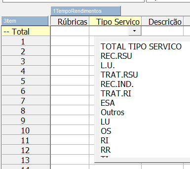

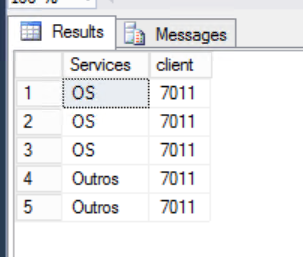

I have a table with: Services, client (image on attachment table.png) this table has a information that i want to load in Rubricas, Tipo Serviço that this elements are a picklist in my TM1 cube, you can see this in elements.png.
So i want to create a TI process to load this columns and update cube with a picklist?
The information that i have in my table i want in the picklist. It's a process to load data in cube.
My output is to load data that is in the table in the cube, for example, i Want to load "OS" (information in table) in a element "Tipo Serviço".

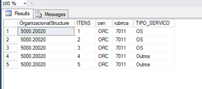

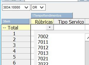

In addition to these columns (Service, Client) I have more information on the other dimensions in the table that are in the cube, such as 3Item, 2organizationalStructure. How i can map this column at the TI process?
On attachement you have the all table structure (my data that i want to load into in cube that it has a picklist are: Rubrica, Tipo_Servico
The other columns represent the others dimensions in cube, the OrganizacionalStructure at table is the dimension in filters in cube, and cen is to in filter in cube.
