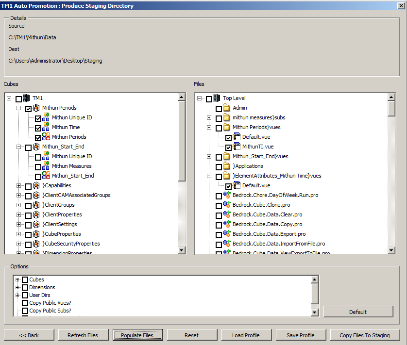

During my early days in TM1 I got really fed up with trying to copy a cube from one server to another usually so i could develop a cube without taking the entire server across :D
It used to be
Bring it up, oops missed an element attributes cube.
Shut it down
Insert }element attributes cube.
oops .dim file missing
shut it down insert dim
Restart
Forget Insert Element attribute .rux file.
Restart
Hey, where did all my views go,
and on it went.
And I thought that there must be a simpler way to do this.
So I began writing (on and off) an Excel VBA program to copy all the
.cub files, .rux files, .dim files, .vue files (both public and private), .sub files (both public and private), .feeders, .blb
And all the relevent }element_attribute cubes rules etc.
From a tree view of the cubes
It works well at the moment, but doesn't do anything too fancy like picklists with 'dimension' etc that aren't a dimension of the selected cubes.
The code hasn't been changed in the last four years.
I was thinking of spend some weekend evenings trying to spruce it up and add some new functionality, but with things like Pulse now on line, do you think its worth it?
Do you think there is any appetite for a free tool like this, or have you guys got something simpler already?
Jules

Hi. nice screenshot and cool idea.
same function places in perfomance modeler.
for models crated in architect i use powershel script.Wich compare each files in two models and generate object to copy(but this is no good solution anyone).

That is a nice looking utility. Presumably you can decide which of the related objects you want to promote? One of the downsides of a number of tools that work out all the connections is that they assume that you will always want to promote all the related objects, which isn't always the case.
I have a utility that generates the TI Script needed to create a cube and all the views on it. Some people say that you should always generate everything from code, but I find that this gives me the convenience of being able to create a view using the cube viewer which is much quicker than writing code, and then have the utility generate the code, which can be promote and amended if necessary.
In general I wouldn't promote the .cub since you would not generally want Dev data going into Prod, unless it is a first release and it is just a reference cube, but there are always exceptions to this.
We still tend to do most promotions overnight, since we don't generally want things changing in the middle of the day. The overnight utility copies in the required files, restarts the service and the start up chore can trigger can import a list of processes to be run to complete the promotion. For example, promoting a new Dim Build Process is all very well, but you will generally need a way to run it, after the promotion. We normally promote to a test environment first to ensure that the promote works correctly before going to Prod.

Yes you can choose multiple cubes and it will pick up all the stuff required.
Its history
It was originally written in PERL as a script but it became too cumbersome (one cube at a time) so I re-wrote it in VBA:
It was very handy for us as originally, we had three completely different systems in production, each system ran independently of the other.
The company frequently re-organised itself, and our development system wasn't very good ( I think it was a Pentium 2 with about 4Gb of ram).
We used this to generate a development copy of part of the prod system to work on, and the subsequent mapping TI's from prod with tons of changes rules etc as the business changed).
This then went to a UAT system (which was then a back to back with prod at year end, but in the re-orged hierarchies and fully reconciled with the help of the accounting teams)
The Current system:
The system also has extra functionality to produce a spreadsheet of all items promoted (just for Audit), and a file state check.
So not only did we have a system backup, any files were that were targeted to be overwritten on the target system had the original files copied into a separate rollback folder. (as a belt and braces approach).
But time marches on:
I've not changed it really in years except for, as Wim says the tree view broke as it doesn't play nice with different versions of excel, and therefore needed tweaking.
It worked but it it never felt polished. (and things like drop down pick lists of dimensions that weren't part of the main cube I never got round to)
I think i'm going to have a go at MCEs way of doing it, then have a nice REST :D
