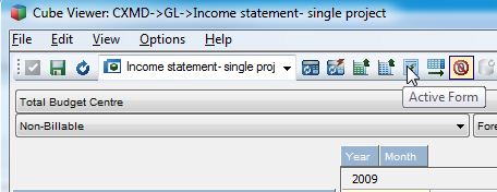

Create a view in tm1
Cube Viewer CXMD-GL-Income statement- single project  _2012-11-08_08-45-45.jpg
Cube Viewer CXMD-GL-Income statement- single project _2012-11-08_08-45-45.jpg (20.22 KiB) Viewed 20879 times

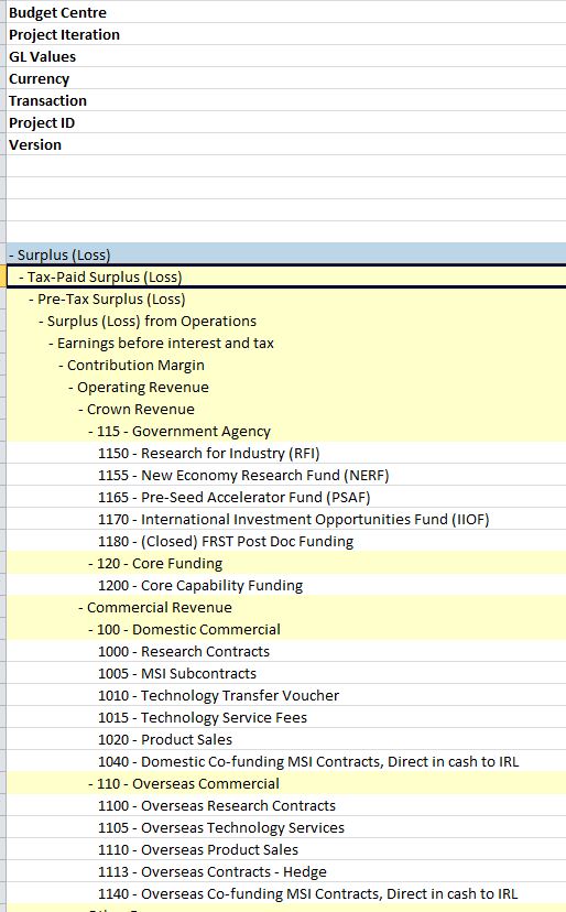

then export to an active form
Microsoft Excel - Book2_2012-11-08_08-46-38.jpg (85.1 KiB) Viewed 20879 times

If you look at your dimension hierarchies, are you building things like Current Assets, Gross Margin and Net Profit as consolidations in your account dimension? This will allow you to build reports based off cube slices that are showing data at highly summarised positions thus doing away for the need for VLOOKUP (to account category) and SUMIF (over that account category). In active forms, when you present the initial report using these high-level consolidations (which could also be used in your department, entity, business unit dimensions etc), you are showing the user the summarised data and then allowing them to drill-down on various rows to access increasing amounts of detail. Furthermore, if you go down this route, you can define and maintain definitions of reports using subsets of these dimensions. E.g. show a breakdown of accounts rolling upto Cost of Goods Sold or, show me all the business units in Territory X.
rmexcel wrote:I do agree that I don't "get it" yet. I will look into it again.
Perhaps you are from a relational background? Oftentimes, people who have had a lot of reporting/ analytics experience in e.g. SQL server initially struggle with OLAP concepts... Perhaps you could try and see the TM1 cube as a big star schema with a few bells and whistles and see where it leads you?
