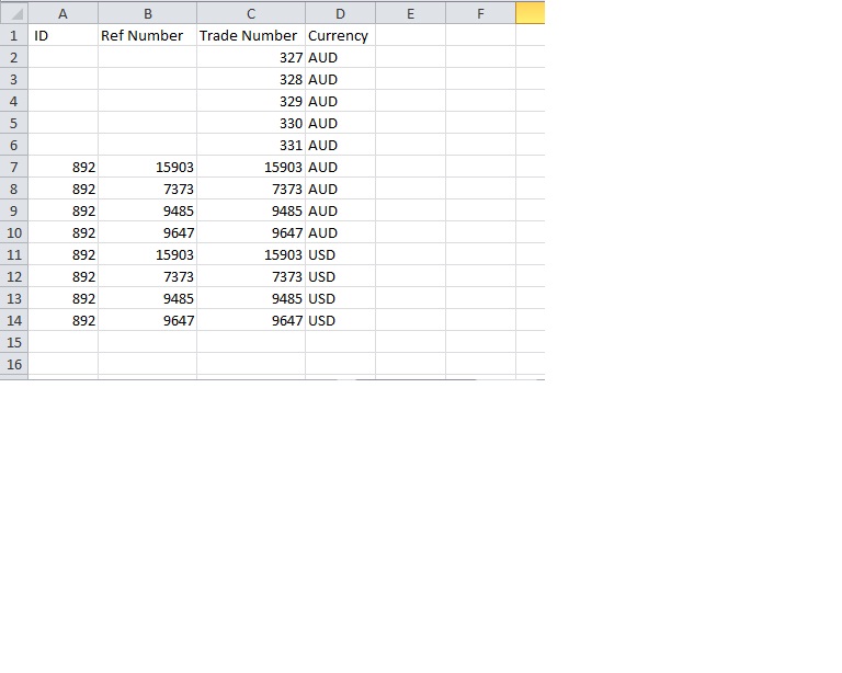

I've a requirement to sort the data in an exported ascii file based on values in two of the columns (Trade Number and Currency). Both these columns are dimensions in the cube for which data is being exported.
The current output is as shown below

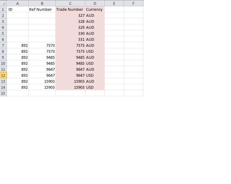

The output is required to be sorted based on the highlighted columns as shown below
