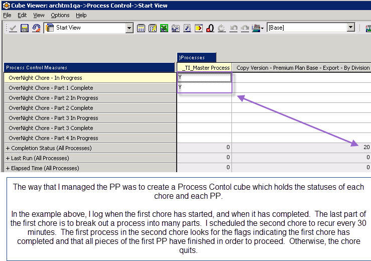

I am currently using the PP in our model. The way that I got it to work nicely was to create a Process Control cube that holds the information as to what part of the chore is running, and/or has completed. I have a chore that starts off the process (daily), and multiple chores that recur every 30 minutes looking for the completed statuses of the chores and processes so it knows when (via a conditional in the TI) to execute the next batch of processes. I mocked up a .jpg of how I came to this setup.
Hope this helps,

Maybe I'm missing something, but I think that your approach ensures that your processes run in sequence, not in parallel. What I'm trying to do is to force a massive amount of calculation through a large complex model in less time than happens now, utilising multiple cores to calculate distinct parts of the same set of cubes, writing the results to a static cube.
Is my understanding (of what you have done) correct?
I overlooked a vital piece of the picture here. The number on the bottom right logs the processes as they finish, but they run concurrently via the TM1RunTI.exe in the Command Line.

I don't ask the TI to wait at the completion of the TM1RunTI execution. I have multiple chores that are scheduled recurring throughout the day, but they only kick off when certain crieria are satisfied.
The policing occurs in the first process of each chore. The example above is the first part of many. For the second chore to execute, the first chore has to be completed, and all the individual threads must be finished processing (which is the number on the bottom right). Otherwise the process executes a ChoreQuit and exits the chore. This chore (along with all the others) will recur throughout the day.
