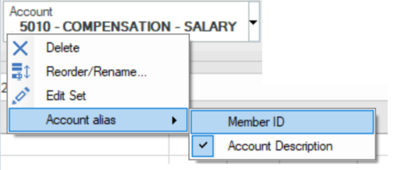

Good point, shows my lack of understand TM1 infrastructure. So, based on attached, my alias ID is "5010" and alias description is "Compensation - Salary? Am I looking at this right? And would would be the function do display the description based on ID?

No one is going to be able to tell you how your system is set up based on what you provided. All that can be deduced with absolute certainty from the screenshot you attached is that the "Account Description" alias in the account dimension for the selected element is "5010 - COMPENSATION - SALARY". What the element's principal name is would be a guess. Based on how systems are usually set up it is likelly "5010" but many systems have fixed length account numbers padded with leading 0s so is could also be "00005010" or it might be something else entirely.
We can't answer this question. But you can easily just by deselecting all aliases, then the principal name will be displayed.

Sorry, I got zero IT background, hence not asking the right question (for this group). I'm on the finance/account side, just trying to understand the tool we are about to implement...
Looks I am getting close to articulating the equation though...
So, if I DIMIX(Cube:Account","5010"), it returns a 4 digit number - 3659 (assuming this is the index number). If I DIMNM("Cube:Account","3659") it returns 5010.
What I'm trying to get to is returning just the description "Compensation - Salary" based on "5010"(alias) or "3659" (index number).
Is "Compensation - Salary" and attribute of "5010" alias? Is there a function to return just the attribute?
