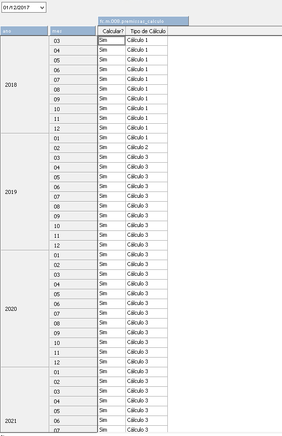

I have a cube like this:
On the top I have the dimension of period. I want to create a process that will copy data from one period to another.

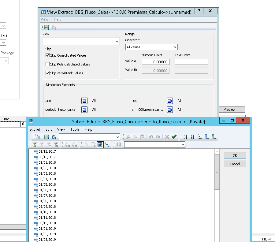

I tried to do this using the view of the cube as source:
But the period that I am going to copy every time that I run the process should be a parameter that user will choose.
So I thought that is not going to work on this case.
I also think in creating a view on prolog with this specific parameters that I want and then writing the data on cube, but I don't know how to do that. I know how to create a view on prolog, but what I've to do to write on data tab using this view as base?

As your process takes a view as data source, your variables will be your dimension elements, plus 1 variable for the value in the cube (that you copy).
So then in the Data tab, use those variables and populate the target cells, for example by keeping everything constant but changing the element for the period.

Hi Wim,
It worked fine.
Thanks a lot for helping.
