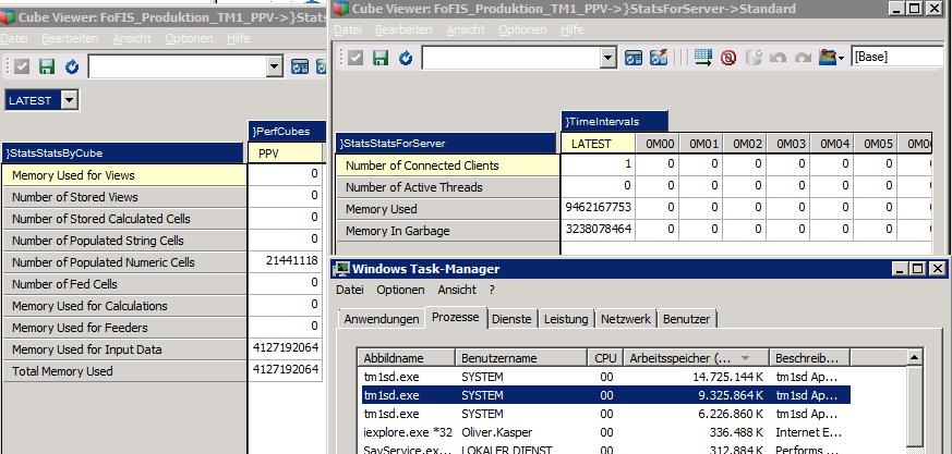

I've a question about the memory usage of TM1.
I don't understand the memory usage while executing a TM1 process. And I absolutly don't find anything with Google etc.
Every time I repeat my process to load data into a cube, it uses more and more memory from Windows. After some time I need to restart the TM1-server to release all allocated memory.
It is not a big deal, but I still want to know why TM1 needs more memory, even if i delete the data from the cube and write exactly the same data again.
As an example:
Right now, I have three TM1-servers. Every department has its own server (fail-over etc.).
A specific example is a TM1-Server with only one Cube called "PPV".
In this Cube, there are 13 dimensions. The biggest one has ~520k elements. The second largest only ~400.
There is no rule for the cube. All calculations are made in the database.
We are loading ~10m data rows into the cube.

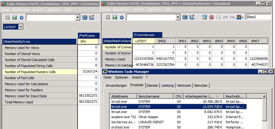

If I restart the TM1-Server, the cube only needs about 3,2GB. The Data is already in the cube in this time. If I repeat the process now to load Data into the Cube, the TM1-Server needs about 5,7GB. Everytime the process is used, TM1 takes about 2,7GB - 3,2GB for each iteration. That means, the server will be using ~25GB in 10 days. (Every night runs a process to delete all data from the cube and then loads the actual data).
For a better understanding, there are attachements with pictures about the TM1 memory usage.
Another question: Why is the "number of populated numeric cells" not constant ? Why is this even getting bigger, even if I use a "CubeClearData"?

I don't have a problem to restart the TM1 Server. But right now, we use three TM1 Servers and after about 10 days all three are using about 100GB from the 500GB on the Windows server. We restart the TM1 servers every month to free the allocated memory.
But also we want to expand our TM1 Usage. That means we want more TM1 Servers.
In my opinion, that means I need to restart the TM1 servers more often. (Every 15 days etc...)
But before we are doing that, I really want to know why this is even happening.
I understand, that a process needs memory to work. But why is the cube getting bigger? Why isn't it just rolling into the garbage?
And why is TM1 not using the garbage for the process again?

Points about this are spread across this board but difficult to find. Basically TM1 caches values for users to come back to. Theory being that if you cache the value rather than calculate it every time you get better performance. When a data change comes in however, TM1 no longer uses that cache as any calculations will also need to be updated. The cache that was used however is not cleared properly. If memory serves (no pun intended, well may be a little) this is a restriction of both TM1 and windows, especially windows. DOS is not great at memory management. Generally it is advised that you should restart your TM1 service once a week to remove the cache and reduce junk memory build up.
I hope this helps. I'm sure others will chime in with a more in depth analysis of this problem but hopefully this should give you a general idea of what you're looking at,
Jim.
Re: TM1 Usage of more Memory each time a Process is used
I don't read or speak German so your TI code doesn't help any but is it possible one of these dimensions is for time, more specifically, days? You say you are reloading the same data every day but are you loading the data to different intersections in the cube? For example, yesterdays data would have been written to June 4, the cube is cleared and then today's data is written to June 5? Here's why I ask: CubeClearData does not release memory. So, if you loaded 2.5GB of data to June 4, clear, and then load 2.5GB of data to June 5 you're going to be using 5GB of memory. Executing the CubeClearData command only makes the June 4 intersections zero, it does not release the memory. The only way I know to release the memory is the take the service down, although it may be released if you unload the cube each day. I'm not sure on that so you would need to test but what you are experiencing makes sense if you are indeed loading to different intersections each day.
