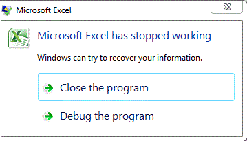

by tm123

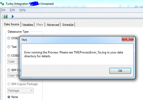

Actually I just tested this. I am running Perspectives from my own desktop, and if I Create a New Process and try to run it, Excel Crashes
If I do the same thing from Architect, then I get the error:

Posted: Tue Jan 16, 2018 3:35 pm
by gtonkin
My Perspectives forces a save first (PA2.0.1) Architect gives same error.
Can only recommend that you save your process then run - without saving, the objects are probably not registered opening up a slew of possible issues.
