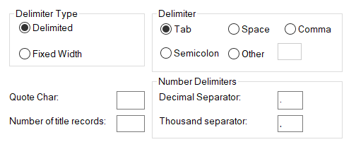

I have a TI process that reads a text file (in this case a .rux file), and I'm using the following settings:

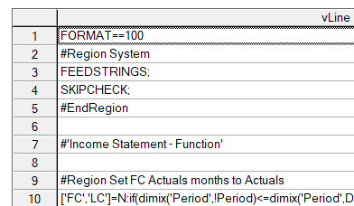

The preview indicates that there are empty rows in the text file:
However, empty rows seems to be ignored when processing the file in the MetaData/Data tab. This is problably by design, and for good reasons, ...but...is it possible to set up the TI process so that empty rows are included and read? Don't ask me why I want to do this. :D
