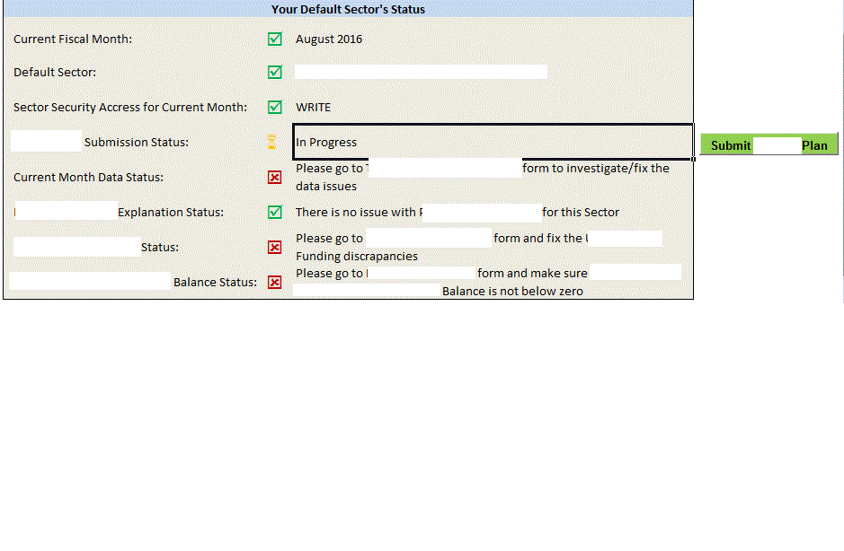

I completely understand, I am not looking for the whole solution but just an Idea on how to manage the different Stages of Planning process. I consider myself an experienced TM1 Consultant and I am not looking for help on how to write the code. In my prior TM1 implementations, I have implemented let's minimum workflows where A Planning Round goes through the following stages:
1-Being_Initialized (During this Time only super-user has access to the Plan, the other user cannot even see it
2-Initialized (This is after the Super user is done with initialization and then he opens it for submission )
3-Work_In_Progress, the user has started to enter Planning Data
3-Submitted (After the user has entered the required data, and there is no issue with data, the user submits the Plan, after this Point the User has Read-Only Access, super-user has Write_Access, so he can either reject and send the stage back to 3-Work_In_Progress, or 4-Final. If only minor changes are required, the Super-User can make the changes himself, so he does not reject it but just make some adjustments)
4-Final (The Super-User approves the submission, the Plan is read-only for Both, planner and Super-User). After this point, the Plan is ready for Reporting
For each user, depending on user's role, in the User's landing Page (Websheet), I have implemented a little dashboard to show the status and to allow the user to submit the plan. ( look at attached screenshot)
This was done with a 3 dimensional cube ( Sector, Month and Measures ), which one of the measures elements being submission stage
ALso I used PowerShell script to send email notifications and trigger them from TI Process execution
Now what I need help is, with a workflow that uses a hierarchy of approving, only some idea, not the solution
Thanks again
