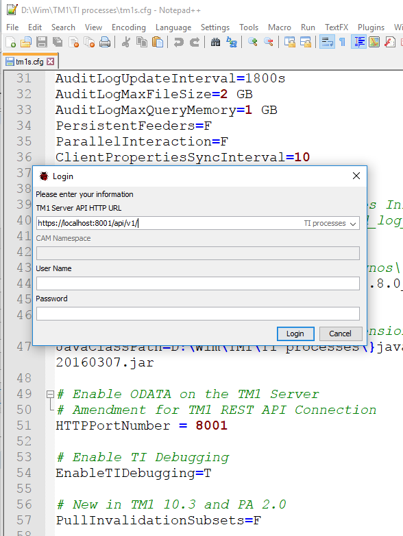

I am using TM1 10.2.2 FP7 and would like to use TI debugger to help debug some of the TIs in the newly-built model.
I follow this http://cogknowhow.tm1.dk/?s=debugger&submit=Search page but clicking on the login button didnt lead me anywhere. I even tested it on the "planning sample" database exactly the same as the example used in the page, and still, nothing happened after clicking on "Login", the debugger login just froze, i had to kill it in taskmanager.

Are you sure the port number is correct ?
You added EnableTIdebugging=T ?
For me it works fine with:

You are right, the port number is 12354, I had it as 12345. Very silly mistake!
