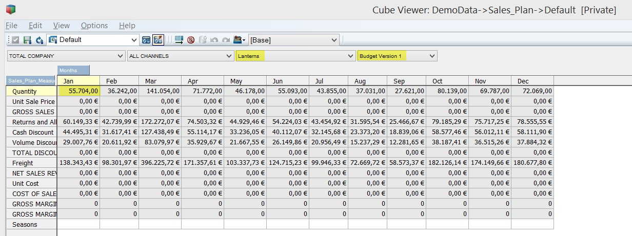

I got the basic concept how store values vs. accumulate values works, but I cannot explain the values from the 6 dimensions cube from the recipe from TM1 Cookbook (Ankit Garg).
Here is the value 55.704,00 for "Quantity" in "January" for "Lanterns", "Budget Version 1", when I select store values:

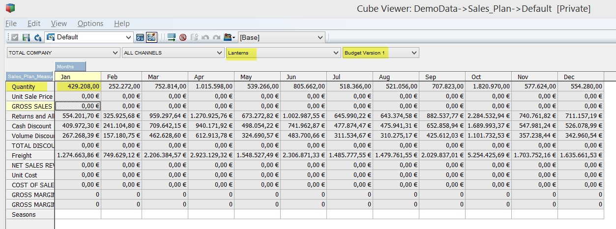

here is the value 429.208,00 for "Quantity" in "January" for "Lanterns", "Budget Version 1", when I select accumulate values:
accumulate values cube.jpg (98.5 KiB) Viewed 56222 times

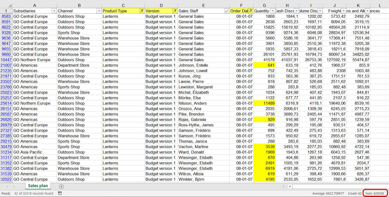

I checked the source excel file and got how the values sum up to 429.208 for accumulate values:
accumulate values excel source.jpg (284.52 KiB) Viewed 56222 times
But I cannot get how the values sum up to 55.704 for store values, I marked these values yellow.
I would appreciate any idea on my example!

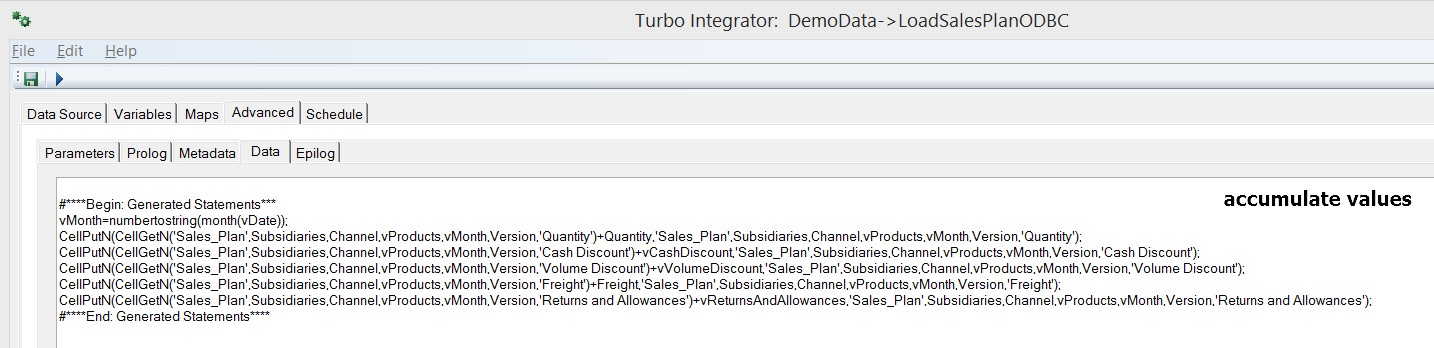

Let me add to this regarding the codes that we use in Turbo Integrator.
You can use CellGetN( ) to get a value from a cube. Then you add a value, usually stored in a variable, representing the value in the incoming record.
After that you do a CellPutN( ) to write the value to the cube, overwriting whatever value is in the cube at that intersection.
This was the traditional approach before TM1 version 10.0 (but still works perfectly). Since version 10.0 we use the function CellIncrementN( ) which does the same task in 1 go. This means less code, less places in the code where fixed or hard-coded values are. I don't think it will matter with respect to performance.
For anyone using the Turbo Integrator wizard, this has not been updated with CellIncrementN( ) and still uses CellPutN( CellGetN( ) )

After posting the question on forum it seems I found the answer. I just needed to sort the dimensions in "A to Z" order starting from the last one in the cube, then it becomes really obvious which values TM1 takes from this excel file in case of Store Values.

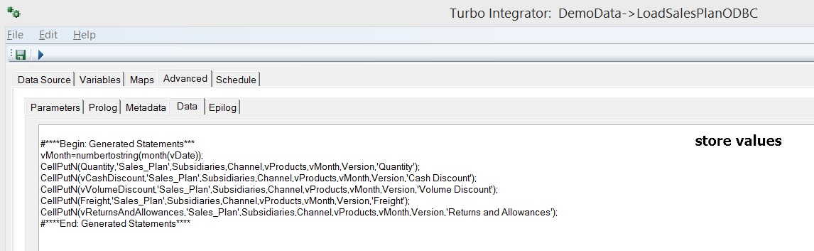

here are the scripts generated by Wizard. Store Values, as you wrote it is CellPutN( ):
script store values.jpg (42.91 KiB) Viewed 55888 times
Accumulate Values, as you wrote it is CellPutN( CellGetN( ) ):
script accumulate values.jpg (66.59 KiB) Viewed 55888 times
