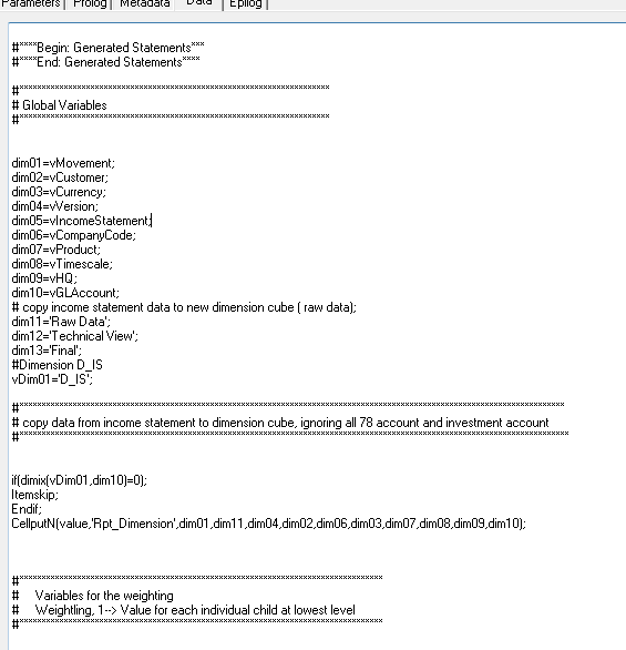

hope someone can help my question,
i am trying to calculate the proportion of each element of its parent;
to put out the data at lowest level;
vDimGL=CellGetN('Rpt_Dimension',dim01,'RawData',dim04,dim02,dim06,dim03,dim07,dim08,dim09,dim10);
copy over to a different column
vDimGL=CellGetN('Rpt_Dimension',dim01,'RawDatatotal',dim04,dim02,dim06,dim03,dim07,dim08,dim09,ELPAR(vDim1,dim10,1));
-584598.02 -584598.02 YTD Technical View Actual 12 Asia BU Reporting 111 2017-12 AAA 6710001011 Acquisition Cost
-289321.79 -873919.81 YTD Technical View Actual 12 Asia BU Reporting 111 2017-12 AAA 6710001014 Acquisition Cost
there is the output file based on above ti process.
it seems calculation was done by line by line
can someone tell how to fix this?
Thanks very much in advance

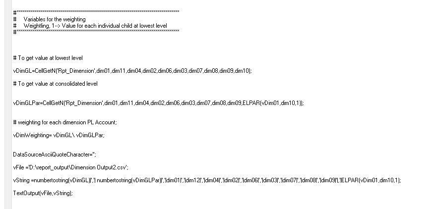

sorry i had some typo in my first post.
no, my goal wasn't to create a output file but i created to test my script.
i had these two lines.
vDimGL=CellGetN('Rpt_Dimension',dim01,dim11,dim04,dim02,dim06,dim03,dim07,dim08,dim09,dim10);
vDimGLPar=CellGetN('Rpt_Dimension',dim01,dim11,dim04,dim02,dim06,dim03,dim07,dim08,dim09,ELPAR(vDim1,dim10,1));
ultimately i want to do vRatio=vDimGL/vDimGLPar to see the weighing of each element;
In this 'Rpt_Dimension' cube, there is a dimension with two elements, one was rawdata, the other one was tech_view
i want to copy the data from 'rawdata' to 'tech view', which is vDimGL
if you look at the output,
i thought the vDimGLPar will return the total of each element, which should be (584598.02 element 1+289321.79 element 2)=873919.81 but if you see the output, the column 2 raw 1 didnt give me what i was after.
any idea?

Here is some dummy code for an allocation:
The cube view gives you values (using a CellGetN or simply NValue or Value or whatever you named the variable in the Variables tab of the process). Then you retrieve the value of the parent.
Get the value to be allocated (could be a different cube).
Calculate the value to be allocated as the multiplication.
Write the result in the cube.
vAccount = NValue;
vAccount_Parent = CellGetN('CubeName', elem01, elem02, elem03, elem04, elem05, ..., ELPAR( vDim, elem6, 1 ));
vRatio = vAccount \ vAccount_Parent;
vToBeAllocated = CellGetN( ..., ..., ... );
vAllocated = vToBeAllocated * vRatio;
CellPutN( vAllocated, 'CubeName', elem01, elem02, 'SOMEWHERE ELSE', elem04, elem05, ..., elem6 );

thanks for your reply,
i think this is what i did,
under vAccount, it has five children (GL account);
vAccount = ( what i wrote was CellGetN('CubeName', elem01, elem02, elem03, elem04, elem05, ..., elem6);
vAccount has 5 children, GL account 1-5; which return $10,$20,$30,$40,$50
vRatio = vAccount \ vAccount_Parent; ( i thought vAccount_Parent can return $150,$150,$150,$150,$150, which can give me ratio 1/15, 2/15,3/15,4/15,5/15);
then i'll allocate some value by vRatio;
i did the whole process i realised something went wrong, that's why i textoutput to see what happened,

yes vAccount is lowest level, vAccountParent is one level above.Wim Gielis wrote: ↑Sat Jul 29, 2017 7:20 am Hello
It's important to understand that vAccount is the lowest level of detail. The values of 10 for each lowest level account will come by in the view of the data source. The values of the parent account will not come by in the view. You will use CellGetN to get those values of 150 for example. Then divide the 2 values. That's all there is to it... what is the problem you still face ? Can you understand the problem based on the TextOutput ? Is your view correct ? Is your zeroout correct?
Parent account is in ram which i understand that's why i textOutput to see what's in vAccountParent.
it gives me
vAccount vAccountParent
10 10
20 30
30 60
40 100
50 150
which gives me incorrect vRatio ;

YTD came from a different cube, when i loaded data to this cube, it has been loaded to YTD which is lowest level;Wim Gielis wrote: ↑Sat Jul 29, 2017 11:11 am My best bet is that you run into trouble with the ELPAR as indicated above.
I guess that you have monthly values for a certain account and instead of getting the parent in the account dimension, you take a YTD parent.
Hence the kind of 'cumulative' calculation in there.
If that is not it and you verified the ELPAR is working 100% correct, add more screenshots of the cube (at level 0 and at the parent level), of the data source, Prolog tab, Variables tab, and so on.
- Posts: 3234
Re: CellPutN and CellGetN question
As asked, please provide clear and meaningul screenshots, otherwise I can continue my trial and error and that's not going to work
Why do you have a CellPutN ?
What is the data source of the process ? A different cube ?
What is the Prolog tab code ?
And so on.
Make the screenshots anonymous if that's why you are not showing them here.
And so on.
i think i know whyWim Gielis wrote: ↑Fri Jul 28, 2017 7:52 am Hello
So your data source of the process is a cube view ?
In that case you will execute the code in the Data tab of the process for every cell in the source view.
Please elaborate more on your data source, do you skip consolidations / rules values / zeroes / ... ?
Can I ask you why you name your cube 'Rpt_Dimension' ?
The syntax regarding CellGetN seems fine.
The goal is to create a text file ? Then you won't need CellPutN.
in prolog i have a viewzeroout to target view
if i comment out this, it will work.
why???
