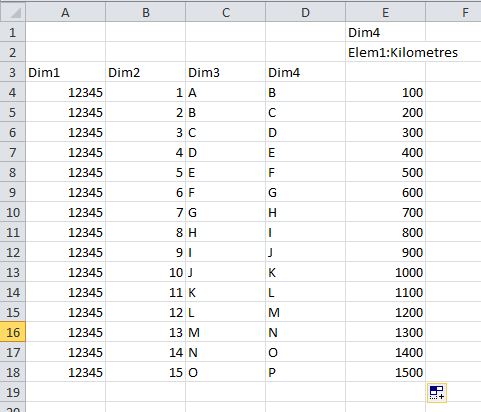

i am stuck with a TI Problem. Maybe you guys could help me.
I have a Cube which looks like the Excel in the Attachements.
I want to sum up the Kilometres. But what i get from my Source is the whole Distance like D to J. So i have to sum up the rows 7 to 12 so I get as a result 3900 Kilometres
The order of the Data is important so i added a Dimension (Dim2) to order the Date during the import.
It is no Problem to sum up all Kilometrs but if i have to it do it just for a specified range, there is where i am stuck.
Maybe you guys have an idea.
Sum up a Range in a View

- Cube View.JPG (53.48 KiB) Viewed 3544 times

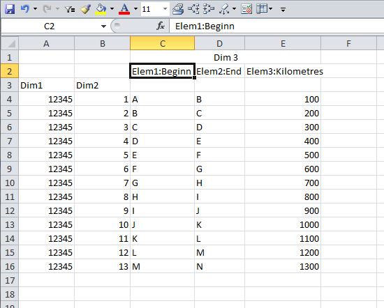

i solved the problem:
I changed my Cube. Now i have the Elem1 and Elem2 as a Dimension
I now a loop to get the ID in Dim2 and a second loop where the while only with the id i got in the first loop.
Memo
Memo
- Cube View.JPG (44.95 KiB) Viewed 3444 times
