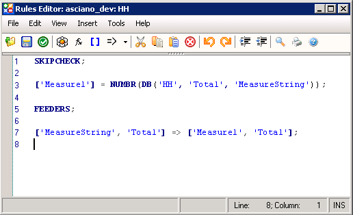

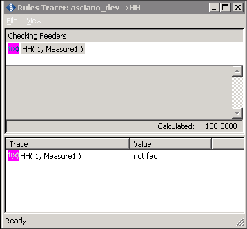

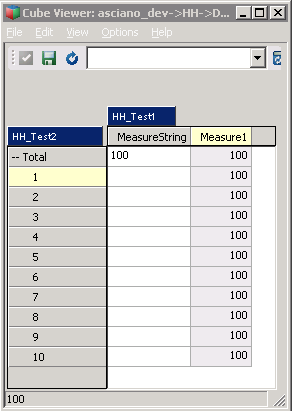

Re: N cells populated from S Consolidation
Hi lotsaram,
You had me intrigued as I never knew that about strings, so I tried it, and it didn't work on 10.2.2 FP1. Suppress zero suppresses all values in Measure1, but if I put a value in any of the items 1..10 for MeasureString the feeder fires and feeds as expected. I would love to understand your reason for why you thought it would work as the concept could prove useful sometimes.
hiraniha
You haven't switched on feeding from/to strings. FEEDSTRINGS is needed either line before or line after after SKIPCHECK.
That should then work as per your test DB. If it doesn't then BUG! ... as strings should feed directly as per definition any string cell is a "leaf".
