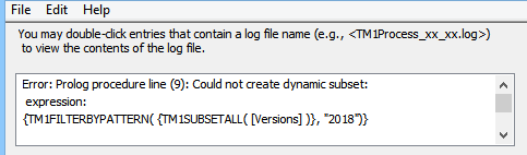

Could not create dynamic subset
Posted: Mon Jan 15, 2018 6:49 pm
by gtonkin
With 10.2.2 FP4 and above you can get around the error thrown by SubsetCreateByMDX when the MDX returns a blank result.
Traditionally you would code something like:
sDim='Versions';
sSubsetName='CurrentVersion';
sMDX='{TM1FILTERBYPATTERN( {TM1SUBSETALL( [Versions] )}, "2018")}';
IF(SubsetExists(sDim,sSubsetName)=1);
SubsetDestroy(sDim,sSubsetName);
ENDIF;
SubsetCreatebyMDX(sSubsetName,sMDX);
Try using the following code which creates the subset first then sets the MDX:
sDim='Versions';
IF(SubsetExists(sDim,sSubsetName)=0);
SubsetCreate(sDim,sSubsetName);
ELSE;
SubsetDeleteAllElements(sDim,sSubsetName);
ENDIF;
SubsetMDXSet(sDim,sSubsetName,sMDX);
Don't forget to follow the SubsetMDXSet with :
SubsetMDXSet(sDim,sSubsetName,'');
To convert from dynamic to static when required. Also consider the new flag (last parameter) to allow temporary objects i.e.:
SubsetCreate(sDim,sSubsetName,1);
